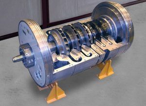

One of the biggest challenges when dealing with turbomachinery (such as pumps, compressors, steam turbines, and others) is low allowable forces and moments on nozzles. This has a great effect on the piping connected to turbomachines and consequently the operation, reliability and maintenance of the machines as well as connected piping. An example is integrally-geared centrifugal compressors where the allowable nozzle loads is often less than half the ones on conventional centrifugal compressors. Allowable nozzle loads of high speed steam turbines and axial compressors have also been low.
The problem is that sensitive turbomachines cannot endure even a slight deformation, or else risk the consequence of shaft misalignment or other issues. To maintain smooth operation, the shaft needs to be kept in perfect alignment without causing binding at the bearings and interference of the internal parts. Therefore, the acceptance criterion of nozzle loads is nearly always the strain rather than the stress. As a very rough indication, the allowable strain on the nozzles of many turbomachines is only equivalent to about 10-20% of the ones when the allowable piping stress criterion is applied.

It is a matter of great debate if turbomachines could be manufactured to take a higher nozzle load without grossly increasing cost and complexity. The answer depends on the type and details of turbomachinery, operational conditions and environments, and the connected and surrounding items. There is usually a weak link in the system: inherent weakness or an item is overlooked in the design.
The turbomachinery body is usually designed and manufactured to be stronger than the piping connected to it, so that the body theoretically can resist the same internal pressure and forces as the piping. The foundation, normally, is also massive and stiff. It is also designed for the piping load and shaft torque as specified.
One of the weak points is the pedestal or base plate. For some turbomachinery packages, the pedestal or baseplate is provided only by shaft torque and machinery weight without considering any piping load or any other loading. This is obviously not enough. The author has observed weak and flimsy pedestals and base plates especially in older designs.
There have been cases where the specified double (2×) or triple (3×) API allowable nozzle loads could be achieved by a stronger base plate or pedestal. In those cases, a strong base plate or pedestal was used, but the overall cost of the turbomachinery package was only marginally more than the package with (1×) API allowable nozzle loads.
The key point is to identify and improve weak link(s) to avoid unnecessary reduction in allowable nozzle loads so the strength and rigidity of the whole turbomachinery package becomes fairly-uniform. This is often a complicated and complex task. Every part, component, connection, etc should be examined within a very crowded and complex turbomachinery package.
