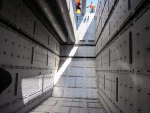

Inside of gas turbine stack[/caption]

Problem
After less than five years in service, measurements and field inspections by Dürr Universal revealed the original silencer baffles exhibited a combination of perforated baffle sheet buckling, vibration failure, and thermal fatigue. In addition, there were signs of external shell overheating due to the movement of insulating pack material, as well as thermal fatigue cracks on several exhaust duct components.
Examination of original baffles suggested premature baffle failures were caused by excessive local buckling of the pack module perforated sheet. The buckling occurred due to the fatigue load combination, including self-weigh, thermal, and disproportionate lateral vibration of the pack module perforated sheet.
Management of the power plant was concerned about the findings and the impact on availability of the unit. Safety was also a key concern because old and failing exhaust baffles posed a potential safety risk if torn steal pieces are ejected from the stack near personnel or adjacent equipment.
Solution
An upgraded exhaust system, including high-performance exhaust baffles with absorptive insulation packing was commissioned to replace the existing exhaust silencer system.
The new retrofit exhaust system featured a similar design as the original system, but the baffle size and geometry were changed to meet stringent requirements for noise attenuation and the need for a more robust structure to avoid potential vibration failures. The new baffle design eliminates raised surfaces on the perforated sheets.
Often-used tack welds of flat sheets can expose leading edges to the high-temperature turbulent exhaust gases, which can cause premature baffle failure and safety concerns with torn steel being ejected from the stack. The new silencer system is supported on reinforced steel concrete pedestals via ordinary concentrically braced steel frames.
Modeling of the baffle boundary conditions/support points accounts for thermal expansion. In additional, the lateral restraint of the baffle at the support seat and guide allow for the free movement within a determined gap. Mechanical means were then used to maintain enough support tension, but still allow for thermal growth.
Along with the seismic load analysis, mode shapes in this baffle example are important because they were used to check for potential vortex shedding around the baffle nose and perforated sheet caused by the internal flow velocity between the baffles. Internal flow velocity can produce low frequencies in the baffle areas, which in turn may overlap with the low structural frequencies of the baffle perforated sheet.
When the flow-induced resonances in the silencer duct are coupled with the significant structural resonances of the baffle perforated plate at the lower frequencies, it may result in violent vibration levels. This ultimately can lead the perforated pack sheet to fail first at weld connections, cause extensive local buckling and failure of pack braces, as well as create the potential for severe deformation and failure of the baffle. Perforated sheet buckling typically occurs when the baffle pack migrates (loss of pack) and interconnected braces fail.
