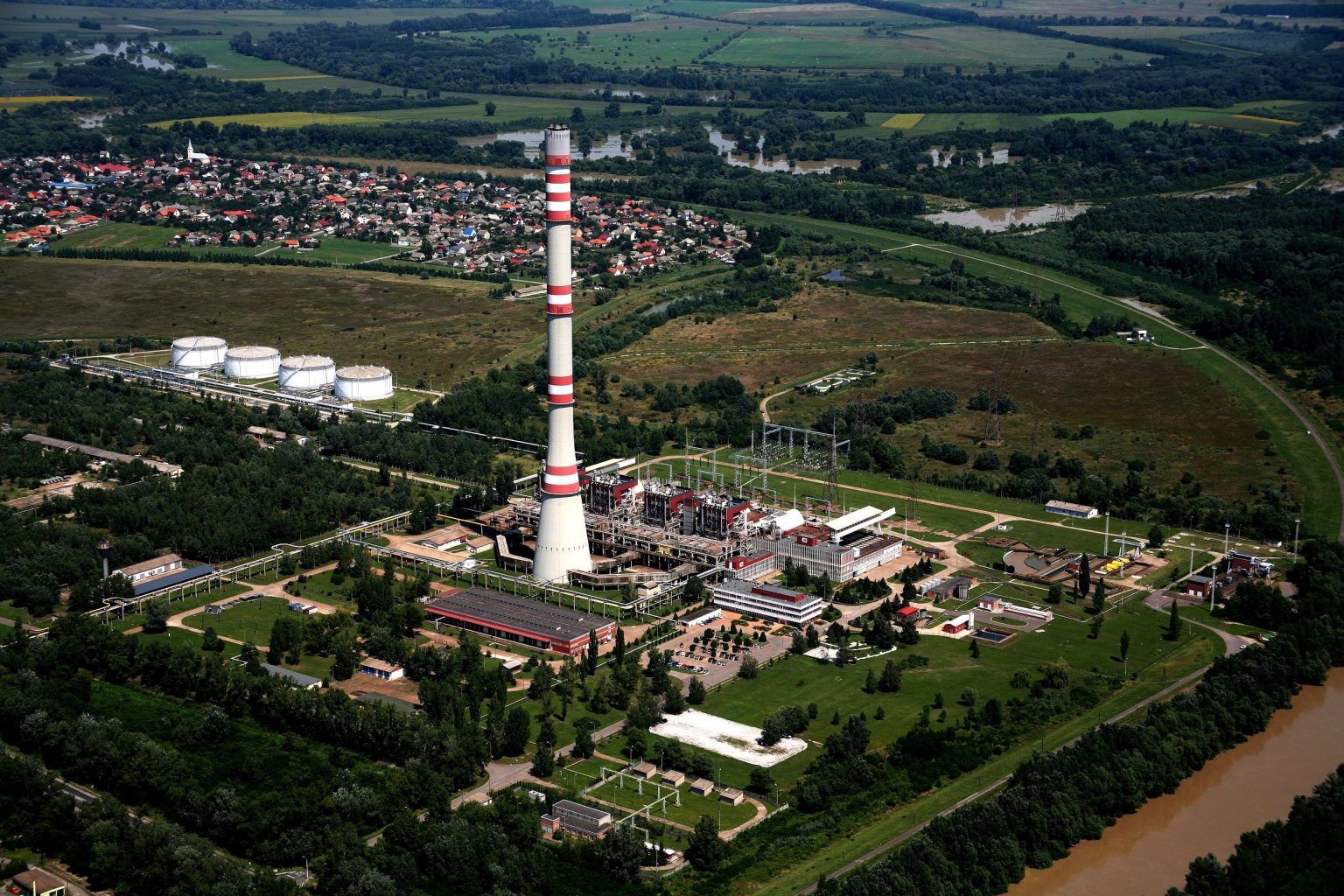

Ansaldo Energia and MVM Tisza Erőmű signed a contract to supply and maintain two gas turbines, two steam turbines, and two associated generators for a combined-cycle gas turbine (CCGT) power plant at the Tiszaújváros site in eastern Hungary. Calik Holding will execute turnkey planning, procurement, and construction while Ansaldo Energia manufactures and maintains its gas turbines under a long-term service agreement.
“The construction of the new power plant is of historic importance, as no new baseload power plant has been built in Hungary in the past one and a half decades,” said Csaba Lantos, Hungarian Minister of Energy. “It is also a crucial step for domestic energy production, as it contributes to strengthening energy independence, improving supply security, and achieving our climate goals. The new facility will balance renewable electricity production, thereby supporting the successful energy transition.”
Once commercial operation starts, the 1,000-MW CCGT power plant will use its two-block construction to generate 7,500 GWh of electricity per year for Hungary’s power grid. In addition, the Tiszaújváros site offers current electricity grid connections, a cooling water system, and local natural gas access, making the MVM facility Hungary’s largest and most efficient plant to date. Ansaldo Energia gas turbine technology is hydrogen-suitable and operates with reliability, high efficiency, and operational flexibility.
“The Tisza CCGT project marks a new era in Eastern Hungary's energy production,” said Károly Mátrai, CEO of the MVM Group. “A modern, flexible generation capacity will be established in place of a previously decommissioned traditional power plant, capable of adapting to increased consumer demand and supporting the integration of planned weather-dependent renewables into the grid. Thanks to the favorable infrastructure and geographical conditions, the investment not only strengthens grid stability but also gives new impetus to the local economy and employment.”
