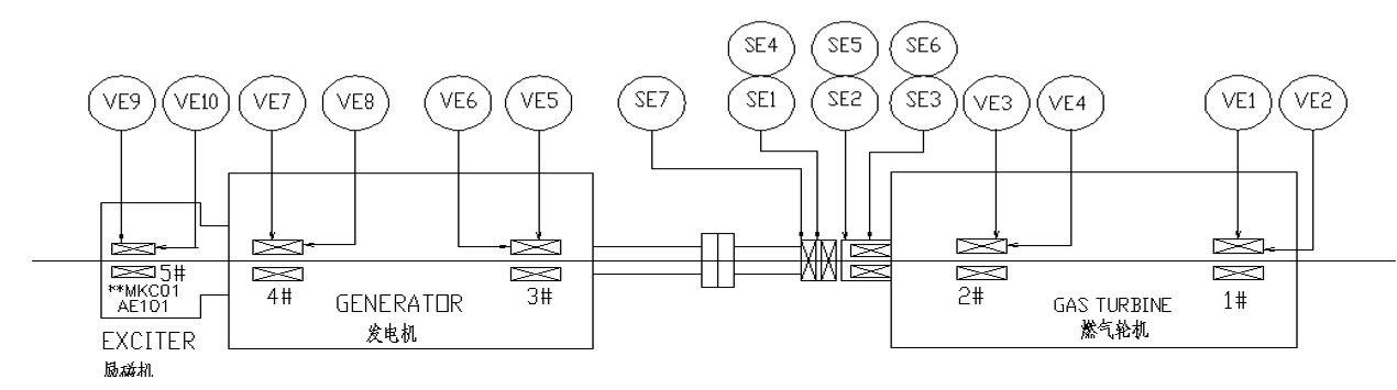

The gas turbine, generator, and exciter will be monitored by a pair of B&K Vibro ds822 X-Y displacement sensors at each bearing of the turbo-generating train. In addition to the sensors for monitoring the shafts and bearings, several ds822 displacement sensors will also be installed for phase/reference/speed measurements and for overspeed monitoring.
The VC-8000 takes in the vibration data for processing, monitors these to alarm limits, generates alerts and a machine trip in case of exceeded alarm limits, and sends data to the turbine supervisory system and operators for control and monitoring purposes.
