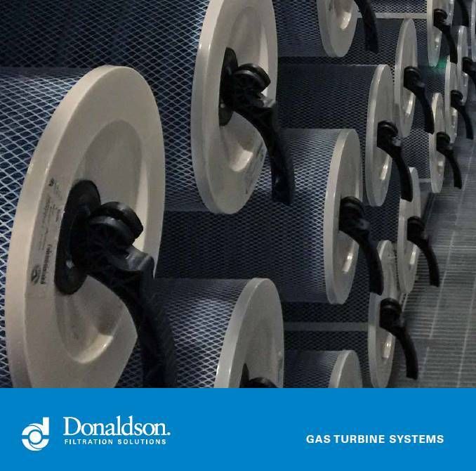

Donaldson
The Gas Turbine Systems division of Donaldson provides engineered filtration solutions for all environments and most air intake and lubrication systems for gas turbines, industrial compressors, and generator sets. Donaldson Turbo-Tek Cartridge Filters use an Er|W|P rating system instead of capture efficiency, as measured by MERV ratings. It also tests for watertightness and pulsability, and rates on a 0 to 5-point scale:
• Efficiency (Er0 to Er5) – what proportion of airborne contaminates does it capture?
• Watertightness (W0 to W5) – how does it handle high humidity and moisture?
• Pulsability (P0 to P5) – How readily do the filters in self-cleaning systems recover peak performance after pulsed with compressed air?
These attributes differ from one filter to another. In combination, they drive operating costs and performance under specific environmental conditions. Donaldson’s filter line can be divided into three categories:
Base medias are economical options that consist of cellulose and synthetic fibers. They are moisture-resistant with a high watertightness rating; however, they have a lower capture efficiency rating (Er1 – Er3) and do not provide (H)EPA-level efficiency.
Performance synthetic range of medias offer F9/MERV 15 efficiency, combined with a P5 pulse recovery rating. This option is for users not needing a high capture efficiency but are dependent on strong pulse recovery in desert or arctic environments, for example, where there is exposure to dust, snow, and ice buildup, or sudden episodes of heavy loading.
Premium (H)EPA filtration captures over 99.5% of 0.1p penetrating particle size. Turbo-Tek H20+ is the most watertight option, rated Er5|W5|P1. Its synthetic media acts as a barrier to water. It is suitable for coastal environments, stopping salts and other corrosive water-soluble contaminants. Turbo-Tek (H)EPA Pulse has surface-loading blended media with a rating of Er5|W1|P4. The P4 pulse recovery rating and high Er5 efficiency rating are best for deserts or areas with a high dust load that depend on a strong pulse recovery.
Cassandra Light, Manager of Gas Turbine Systems for the Americas and APAC, Donaldson Company, gave the example of a plant on the humid Australian coast using Turbo-Tek H20+ filters. The air was laden with sea salt and smoke from nearby brush fires, yet filter life rose from 18 months to 48 months with 0% loss in compressor efficiency, stable differential pressure across the filters (DP), clean blades, and elimination of on-line water washes of the filters.
“A site in a harsh environment in China with a high volume of hydrocarbons has increased filter life from one year to nearly three years and has eliminated water washes (on-line or off-line) altogether,” said Light.
In addition to filtration for gas turbine air intake systems, the Donaldson Gas Turbine Systems Quick Lock Yoke filter retention system ensures secure installation and reduces filter changeout time. Light said that in a test, the time required for filter replacement could be reduced by a little less than half.
