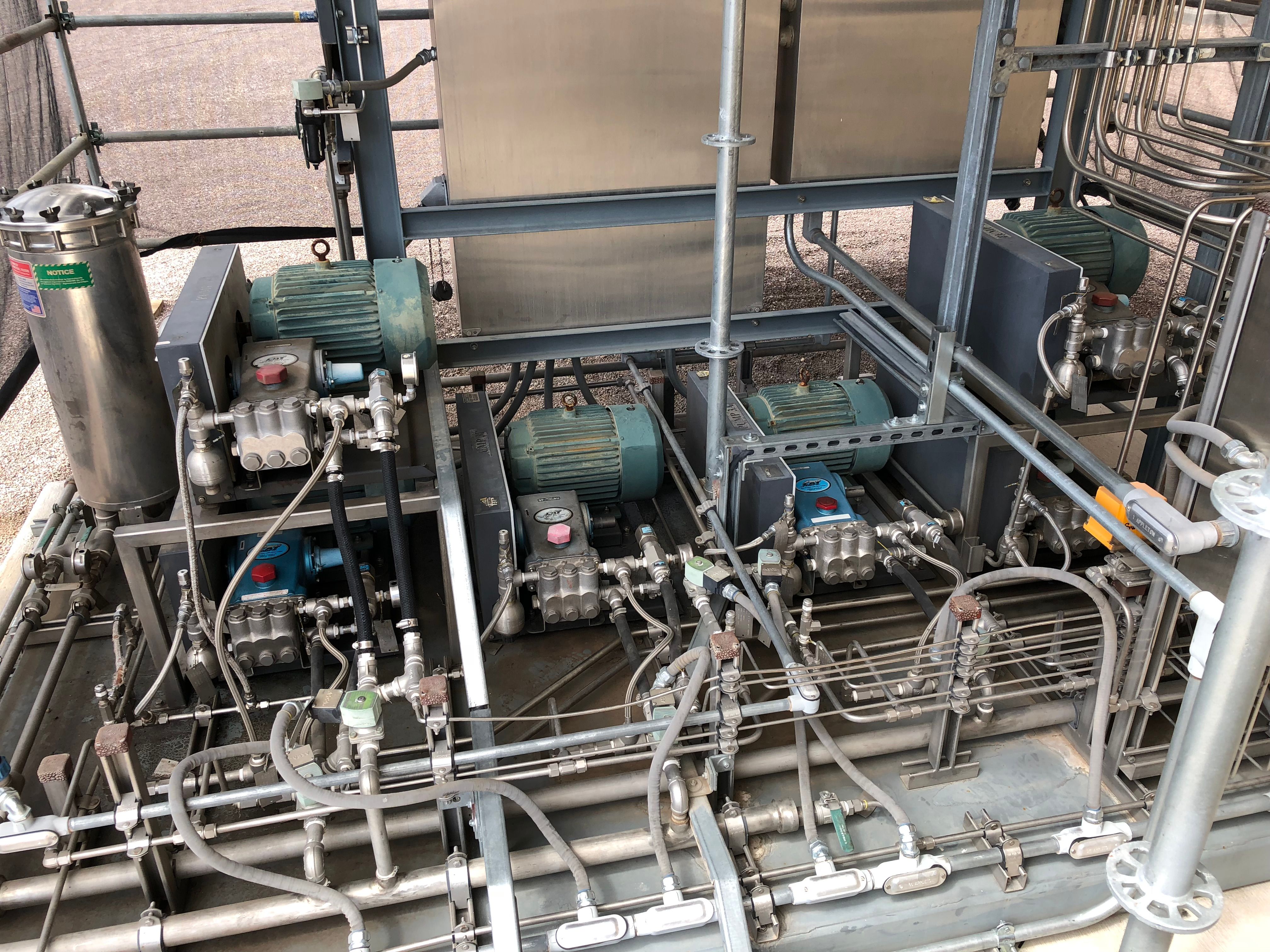

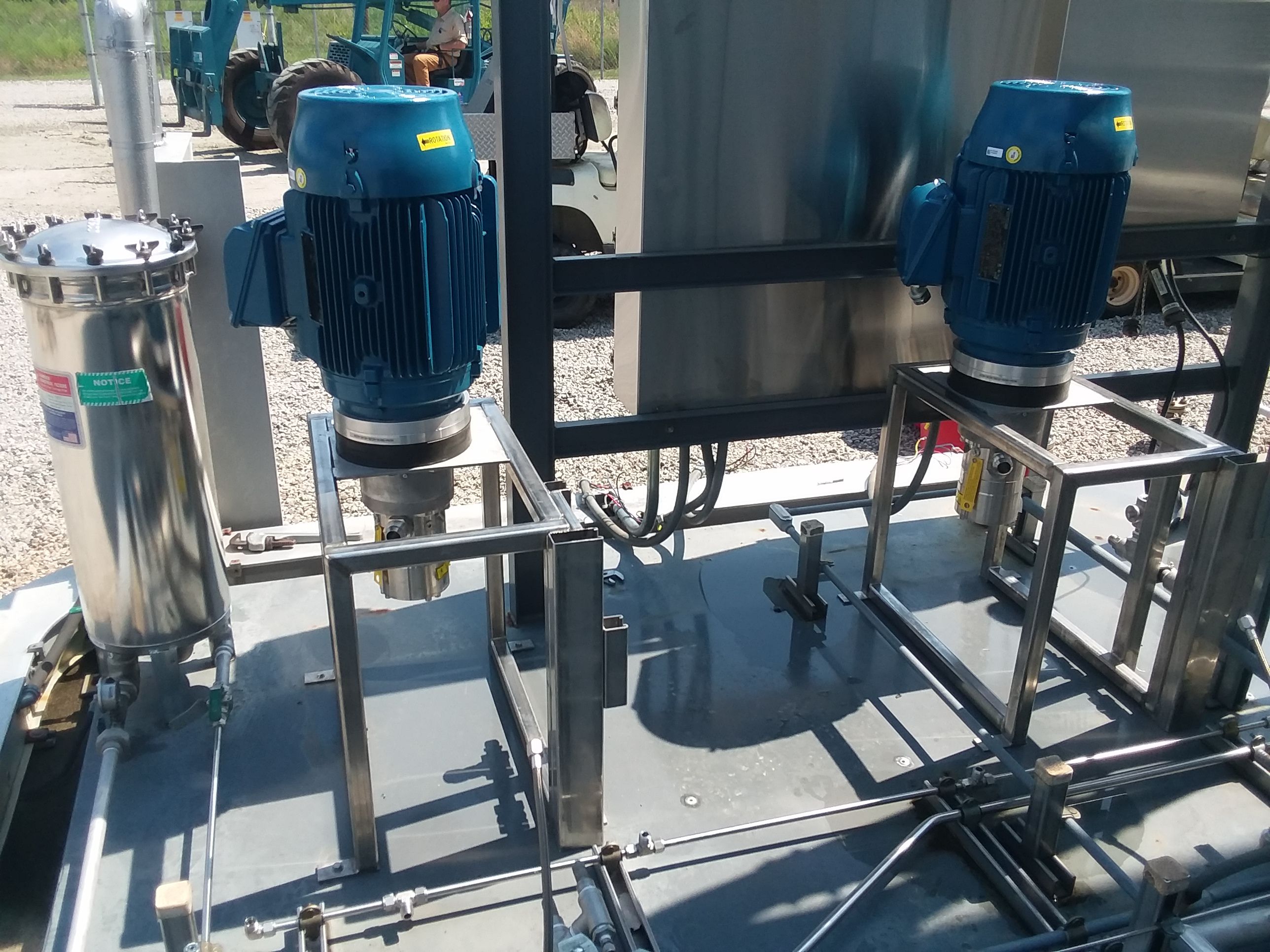

Modern high-pressure pumps require much less maintenance than older pumps. Older ceramic plunger pumps can be replaced with seal-flushed pumps, which can operate for several cooling seasons without needing their seals changed. Another option is to upgrade to water lubricated pumps. These pumps are direct-drive, so there are no drive belts to service, and they have no crank case oil to replace. They can operate 8,000 hours or more before requiring maintenance.

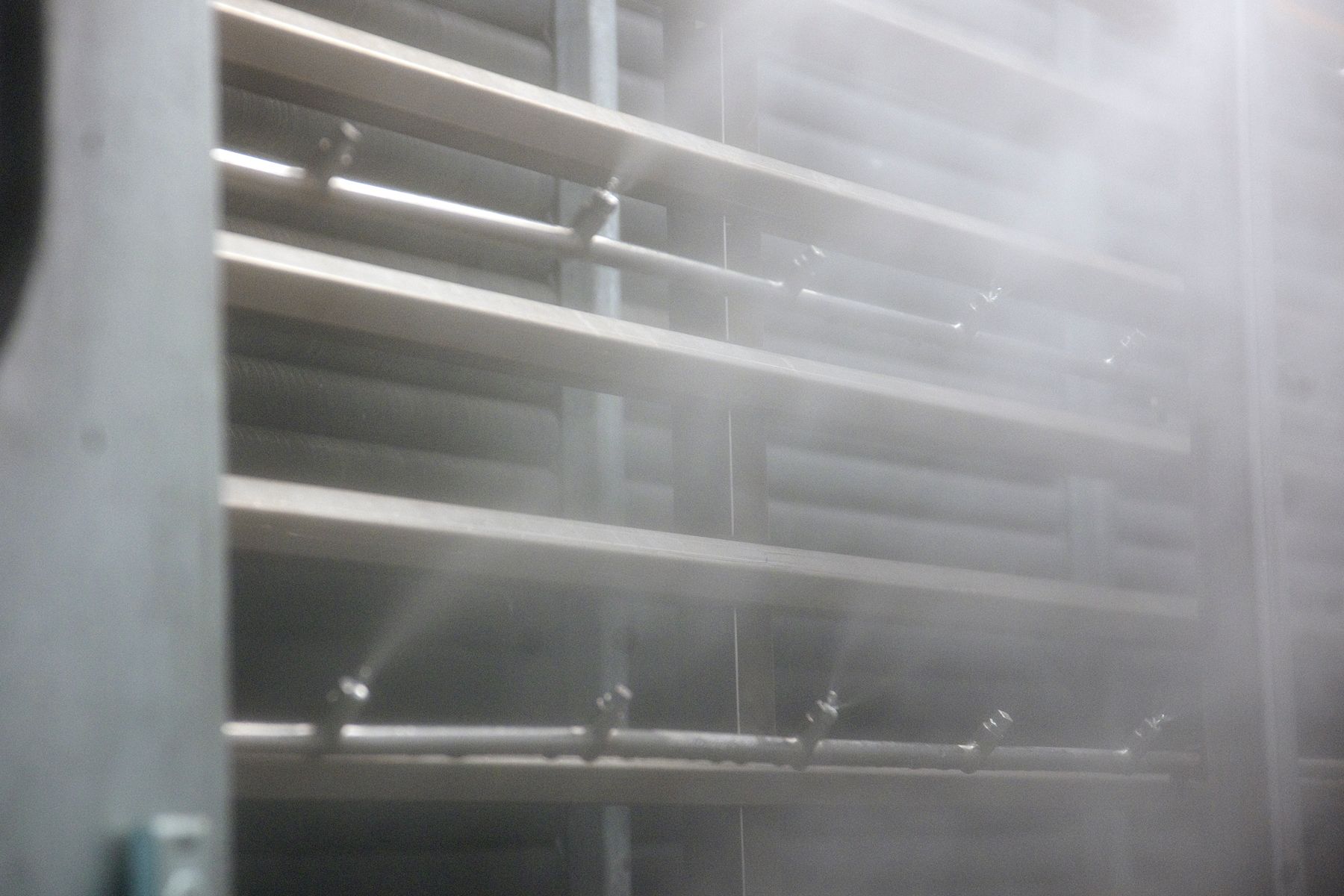

Some early fog systems had nozzle manifolds that didn’t cover the full cross section of the inlet duct, meaning as much as thirty-percent of the air was not fogged. Correcting this problem with new nozzle lines can increase the power boost by a megawatt or two on a large turbine.
Further, the addition of high-pressure filters and automatic drain valves can reduce nozzle plugging. If a fog system is not used for several days, and stagnant water is left in the high-pressure lines, biological growth can occur, which can lead to fog nozzle plugging.

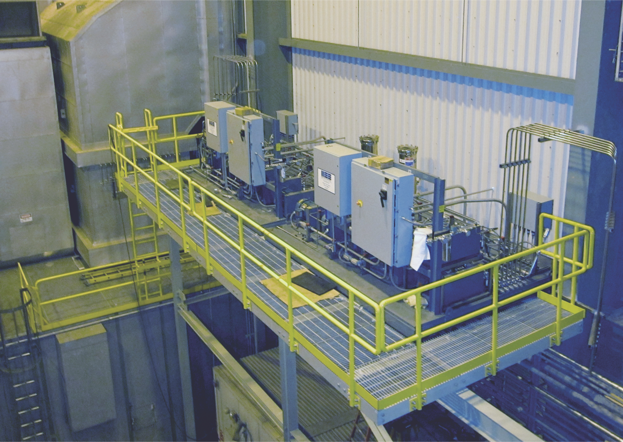

Each SwiftPac unit has its own fog skid. The skids provide high-pressure water to two nozzle grids that are located in the inlets of each of the FT8 gas turbines that comprise the SwiftPac. The original skids offered eleven stages of fogging, with enough fog to saturate the air on a hot day, plus two additional stages that gave an additional wet compression power boost—power augmentation that occurs when the fog spray evaporates inside the compressor.
The Clark Generating Station upgraded the fogging systems ten years later in 2018. The number of fogging stages was greatly reduced in the upgrade. Shambo noted that the plant generally needs all possible power immediately. Therefore, there was no need for a sophisticated arrangement of incremental stages of fogging. The new skids each only offer two stages of cooling. “Two stages are more than enough for peakers because we are either off or full on,” said Shambo. “The revised PLC is performing very well.”
Each of the twelve original skids had six ceramic-plunger pumps. These pumps were replaced with two water-lubricated pumps per skid. The results have been worthwhile, according to Shambo. The water-lubricated pumps don’t need any lubrication and require almost no attention. This is a welcome relief to the maintenance department. The plant went from having to maintain 72 pumps with associated motors, belts and lubrication and seal-change requirements to only having to take care of 24 direct-drive pumps.
The original Siemens PLCs on each skid were replaced with PLCs with upgraded control logic. They are programmed to receive data from a weather station onboard the skid. The PLCs operate fog stages to maintain saturation at the turbine inlets as weather conditions vary. The PLC is tied into the plant DCS.
