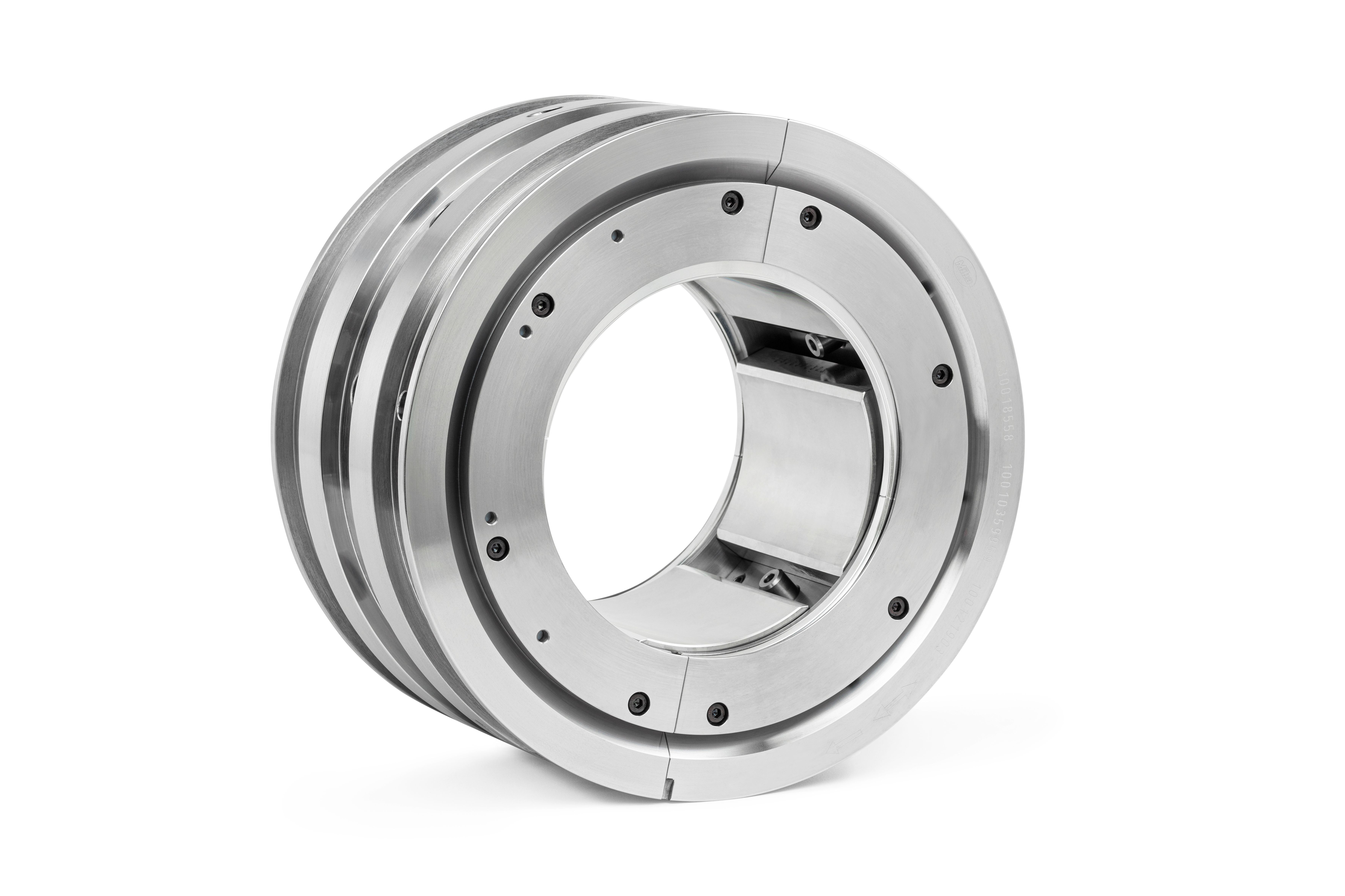

Tilting pad journal bearings are used in turbocompressors, turbo gears, gas turbines, and steam turbines.
Tilting pad journal bearings are used in rotating equipment such as turbocompressors, turbo gears, gas turbines, and steam turbines. The development trends for these applications create a growing demand for bearings with increased load carrying capacity or increased power density. This goal must be achieved without an impairment of bearing functionality or operational reliability.
Conventional bearings have performance limits that can be reached or exceeded in turbomachinery applications due to different reasons. To overcome traditional operational limits, it is often necessary to reduce the oil film temperatures. Several design optimizations are known.

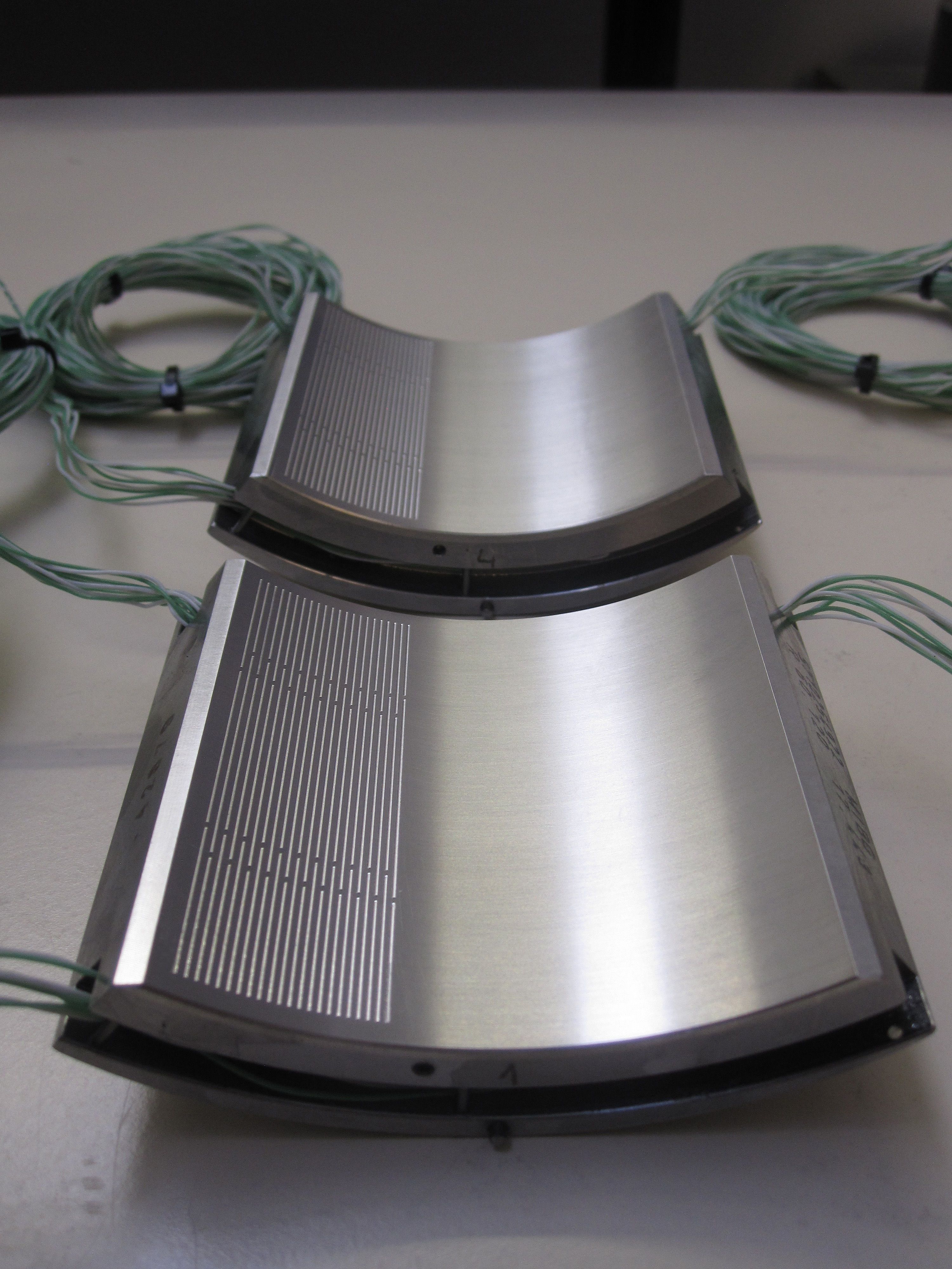

By disturbing the laminar flow regime with grooves, the flow is locally converted from laminar to turbulent. The radial flow components of turbulence improve heat exchange between high temperature loads and cooler areas.

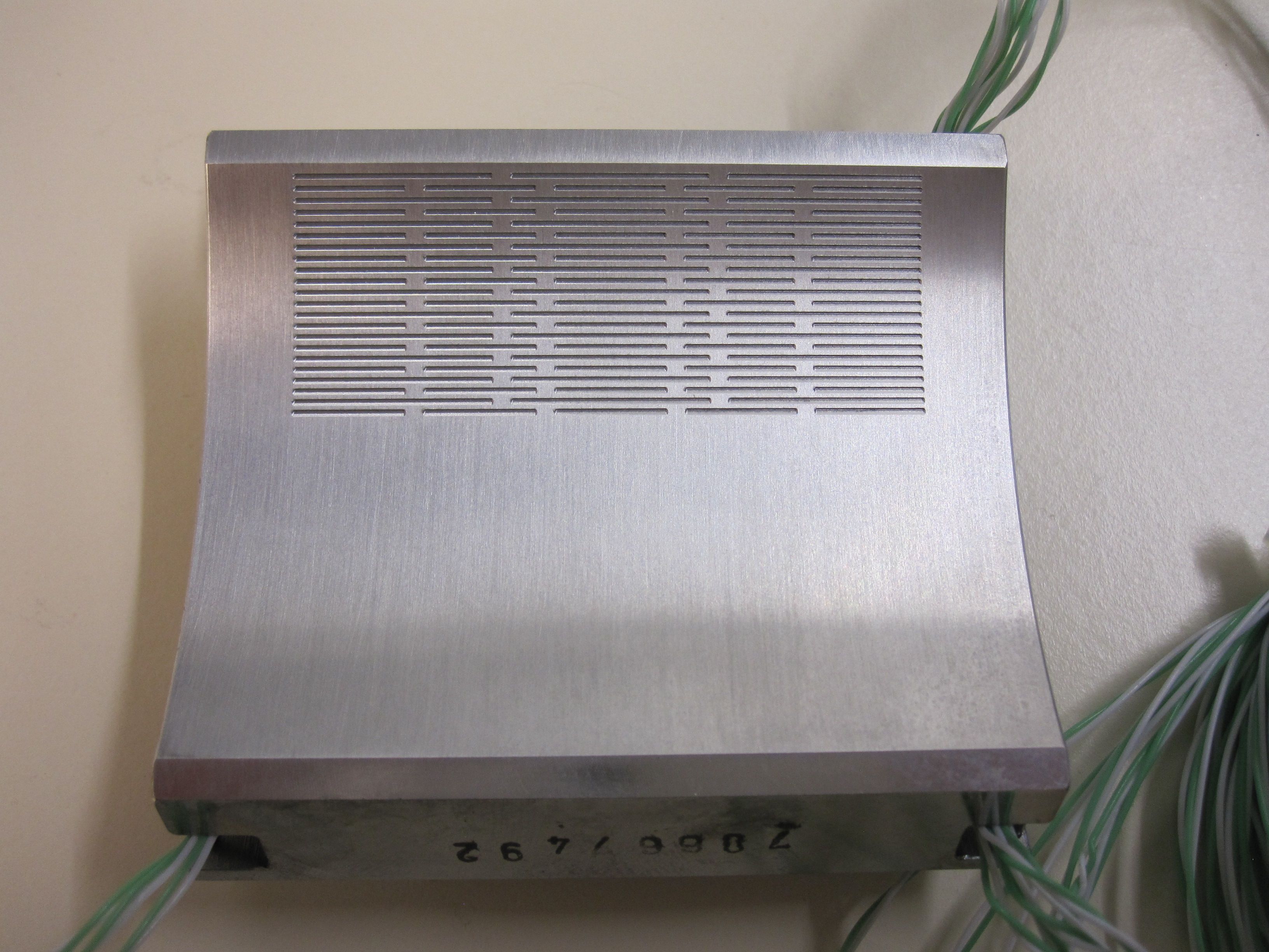

A major cause of high local bearing temperatures and low heat dissipation is the laminar flow regime of the lubricating oil i.e., the lack of radial flow velocities in combination with low thermal conductivity of the medium. Eddy groove technology is a way to solve such heat dissipation issues. By disturbing the laminar flow regime with grooves, the flow is locally converted from laminar to turbulent. The radial flow components of turbulence improve heat exchange between high temperature loads and cooler areas. This makes it possible to push performance limits upwards without changing the general bearing or housing design while maintaining or improving reliability and operational safety.
An article discussed the performance improvement gained from eddy grooves (published in 2021, written by Schüler E, Berner O.) on a 5-tilting pad journal bearing with a bore diameter of 120 mm at a speed range of 50 – 110 m/s and a load range of 0 – 4 MPa. Temperature sensors close to the sliding surface determined maximum temperatures. Tests confirmed a significant surface temperature reduction.
To date, the technology has been experimentally verified on bearings with shaft diameter of 120 and 500 mm. In addition, the first 60 mm diameter eddy groove tilting pad bearing was installed in January 2021 in an integrally geared compressor. The machine is operating and its former bearing temperature problems have been resolved.
In summary, eddy groove technology can be beneficial for highly loaded bearings that operate near their performance limits as a means of increasing the reliability and availability of turbomachinery. In some cases, reduced maximum temperatures may also allow a reduction in bearing size, which would lead to lower oil demand and reduced power losses of the bearing, while keeping temperatures at an acceptable level. ■
