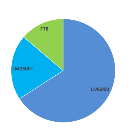

2024 was a strong year for GE/Baker Hughes’ LM6000 and LM2500+G4.
“GE/Baker Hughes LM2500+ remains one of the most popular models in the world for the last 25 years,” Brough said. It has 1,458 units in fleet and accounted for 44% of the aeroderivative market (EPU and O&G models) over the past five years, growing at a compound annual growth rate (CAGR) of 4.1%. However, he said the Solar Titan 250 has displaced the LM2500 base engine business, and the introduction of the Solar Titan 350 poses a strong challenge to the 35+ MW LM2500+.
In 2024, GE/Baker Hughes LM6000 boasted 45 unit orders, but the LMS100 and LM9000 came up short with zero orders, though it is believed Baker Hughes is entertaining a lot of interest in the LM9000. The LM6000 has 1,235 units in fleet and improved its market share over the past five years to 16.4% with a CAGR of 1.8%.
Brough also noted a resurgence of the MHI FT8 in 2024, with 16 units ordered.
In 2023, GE/Baker Hughes’s five-year market share was 61%; in 2024, it increased to 63.7%. Siemens Energy and Rolls-Royce both held 8.1% and 4.5% in 2023 and 2024, respectively; MHI/PWPS held 3.6% in 2023 and 5.4% in 2024, and UEC (Russian Aero) held 9.5% and 9.3% in 2023 and 2024, respectively, according to Dora Partners & Company. The company predicts $3.6 billion per year will be spent on gas turbine maintenance, repair, and overhaul.
In North America, aeroderivative unit orders saw a 48% increase and a 236% increase in MW orders in 2023 versus 2024, and GE/Baker Hughes’s MW share was 79.6% in 2023. Globally, aeroderivative unit orders were down 14% in 2024, and MW orders were up 10%. GE/Baker Hughes’s global share was 73% in MWs in 2024.
