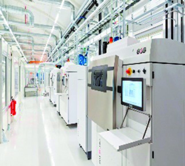

SIEMENS SHOWCASES ADDITIVE MANUFACTURING CENTER
Siemens new 3D printing center in Finspång
Additive manufacturing (AM or 3D printing) has gained  greater acceptance since we ran a cover story on it last year (Turbomachinery International, May/June 2015). Siemens is the latest to occupy the headlines with the unveiling of its expanded Finspång AM center in Sweden for the prototyping, manufacture and repair of metal parts for gas turbines (GTs).
“With this investment, we can develop new and improved components and repairs to serve our SGT-800 GT much faster, shorten repair times from months to weeks, and respond to the needs of our customers,” said Hans Holmström, CEO of Siemens Industrial Turbomachinery.
3D printing is the process of making workpieces and products by welding, sintering, or bonding layer upon layer of specific materials. Siemens has been active in 3D printing since 1989 and now it is seeking to industrialize the technology.
Integrating 3D printing
Siemens is integrating 3D printing with computer-aided design (CAD) software, controls technology, automation, and drive systems to be able to digitally model all processes.
As well as the new facility in Sweden, Siemens recently acquired an 85% stake in Materials Solutions, a pioneer in the use of Selective Laser Melting (SLM) technology for the manufacture of high-performance metal parts. A specialty of the company was the making of turbomachinery parts, particularly high temperature applications for GTs.
At Finspång, therefore, Siemens can now take advantage of the latest SLM machinery capable of producing physical parts directly from digital models. First, a 3D CAD model of the desired object is created; then the SLM system produces the 3D object by building it up, one layer at a time, from a powder material. The powder is placed in the defined areas and melted by a laser beam, which hardens the product.
These SLM machines can be used to manufacture tailor-made products, refine conventionally mass-produced articles through the addition of personalized components, enable spare parts to be produced on demand and create structures that cannot be achieved with conventional methods.
For example, components currently manufactured in solid form can be produced in an additive manufacturing process with the required cavities already integrated. They are said to be as strong as their current counterparts, lighter and require less material.
Difficult application
Due to high temperatures and pressures, high rotation speeds, and the large parts involved, turbomachinery is one of the most difficult application fields for AM. The Finspång facility will provide a way to heighten reliability by creating links to production simulations in the design phase.
The benefits are said to be bringing products to market up to 90% faster, reducing R&D and prototyping loops by 75%, and performing repairs in one-tenth of the usual time. Metal powder from the process can be recycled and used again, which leads to a reduction in scrapped material.
“As a result of a redesign of the SGT-700/800 nozzle and its lattice structure, which was not possible with conventional production methods, these turbine types can now handle up to 60% hydrogen, and we are aiming for 100%,” said Holmström. “Our 3D printed burner nozzle allows co-firing at higher combustion temperatures thanks to an improved burner tip design, or can can operate together with natural gas to reduce emission levels.”
SGT-700/800 burner fronts were traditionally manufactured with 13 components and 18 welds, whereas the new SLM-manufactured front consists of one component and two welds. With the burner tip for the SGT-700/SGT-800 3D printed, it is now ten times faster to produce. And spare parts are being made on demand such as the burner heads for the SGT-1000F.
