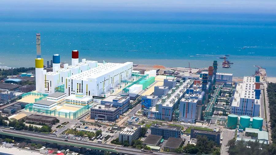

The Taiwan Power Co. granted Mitsubishi Power and CTCI Corp. a $5.2 billion contract to execute a full turnkey project at its 2,800-MW Tung Hsiao power plant in Miaoli County, Taiwan. Mitsubishi Power will deliver five units with M501 JAC gas turbines, steam turbines, and auxiliary equipment, while CTCI performs engineering, procurement, and construction and balance-of-plant work for the gas turbine combined cycle (GTCC) project.
The five new turbine units will begin operation sequentially from 2030 to 2031, with generators supplied by Mitsubishi Generator Co. Several GTCC power plants, updated in the renewal’s first phase and located near the new facility, are equipped with three M501 JAC units operating since 2018. These units arrived following a joint contract awarded to Mitsubishi Power and CTCI in 2013.
Taiwan Power’s Tung Hsiao plant is located approximately 130 km southwest of Taipei and based on Taiwan’s long-term power supply and development plan, it will replace existing power plants once renewal work is completed. The renovation aims to increase power generation capacity and reduce environmental impact, while meeting the region’s rising industrial and residential electricity demand. In addition, the project also helps Taiwan in meeting its net-zero emissions goal.
