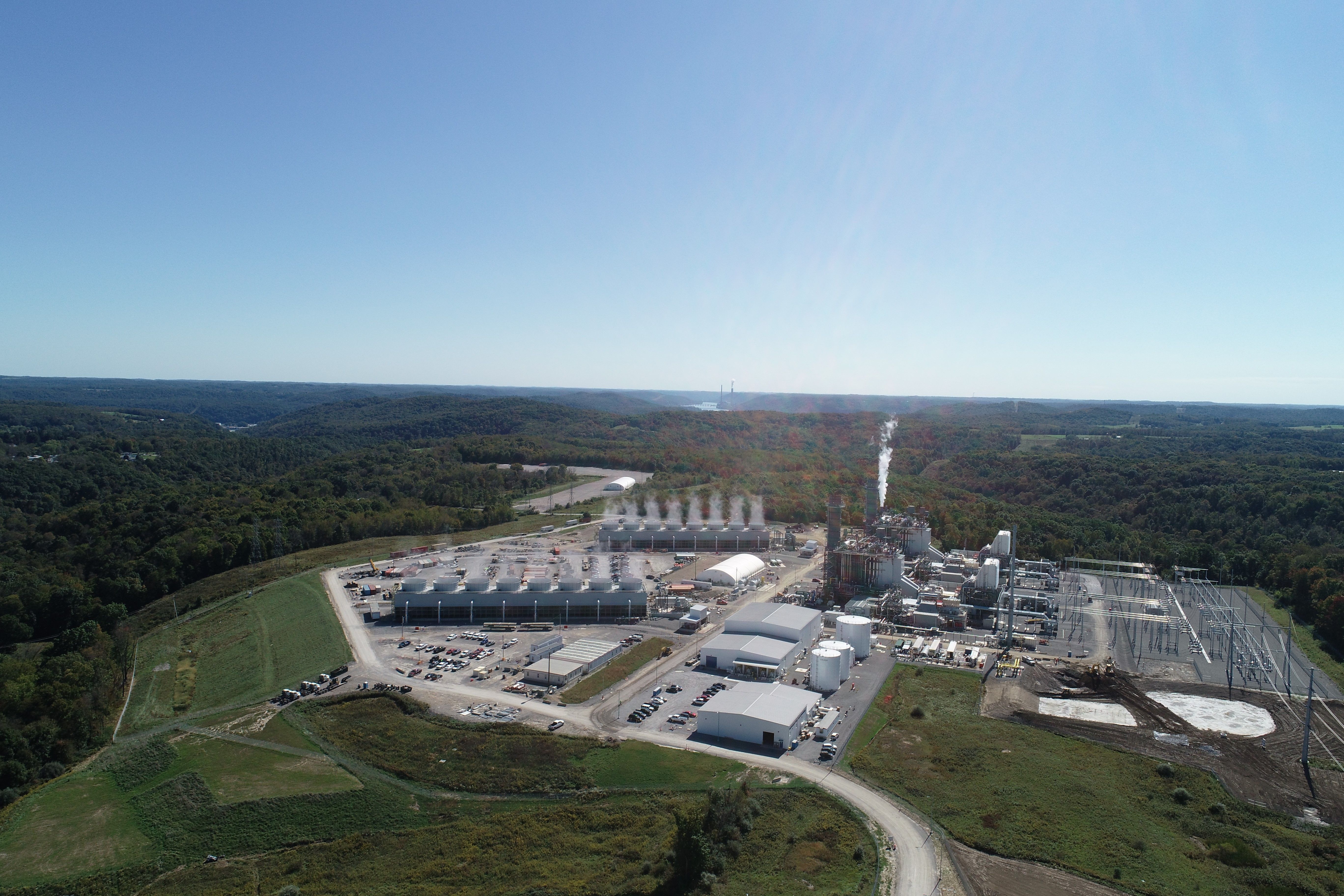

Ohio combined cycle plant adds 1 GW to the grid
