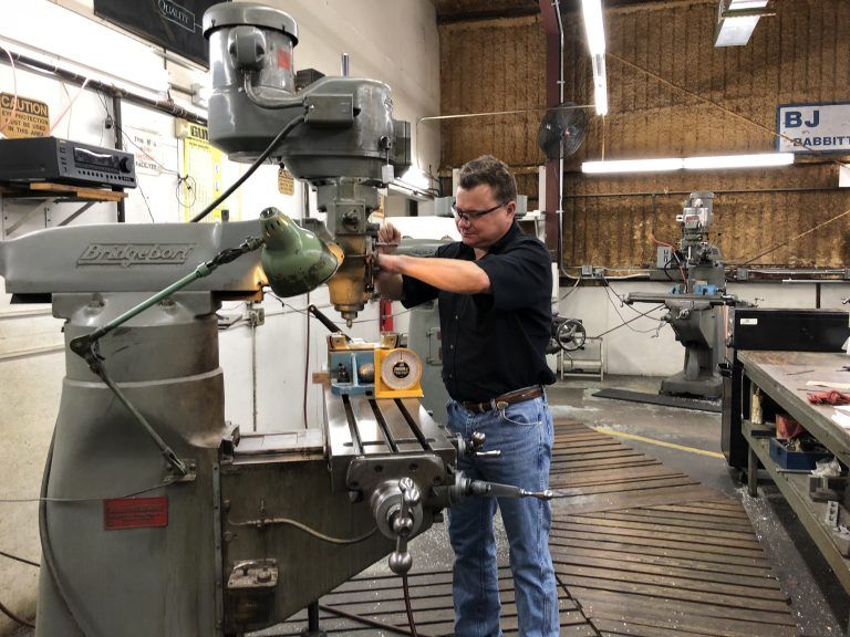

Turbomachinery International spoke with John Bartos, CEO of Rotating Machinery Services (RMS), about the company’s most recent acquisition of BJ Superior (BJS)—a manufacturer and service provider of babbitted bearings, labyrinth seals, and thrust assemblies. Bartos detailed the benefits of adding BJS to the RMS family, in addition to explaining the technical and market significance of advanced machining and in-house maintenance services.
