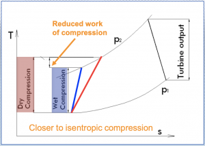

Wet compression consists of spraying atomized water into the compressor of a gas turbine engine. It is usually done after the air has been fully humidified by fogging, evaporative cooling with a media-type cooler or by chilling the air to below the ambient dew point temperature. The heat of compression causes the water droplets to evaporate inside the compressor where they provide an inter-cooling effect. This reduces the work of compression. Since the compressor consumes less power, more power is available at the GT output shaft.
A gas turbine compressor consumes half or more of the work produced by the expansion turbine. Therefore, an increase in compressor efficiency can produce a significant rise in the power output and fuel efficiency of a gas turbine. The added mass flow of water also causes a power increase. But this is small compared to the power boost resulting from the reduced work of compression.

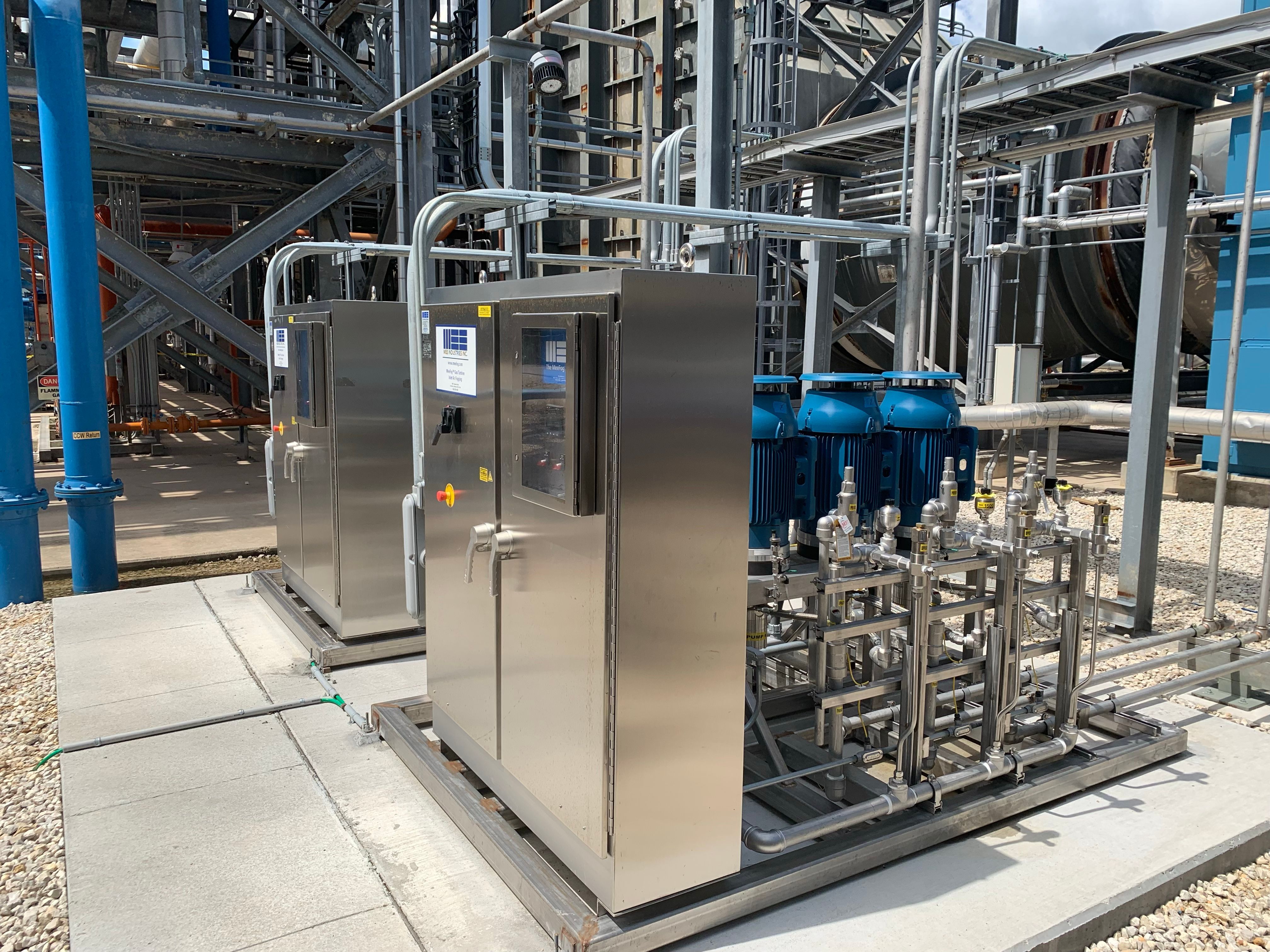

In 2010, Ingistov removed the once-through, 150 gpm evaporative coolers, in part due to regulatory pressure to reduce the amount of water consumed. He relocated the nozzle arrays upstream of the silencer panels, with the fog nozzles aligned so they sprayed into the gaps between the panels. The new nozzle arrays spray 30 gpm of fog, which equates to 30°F of cooling, or 0.67% of the air mass flow, for the GE 7EA turbines.

The facility has ran only the 30 gpm MeeFog systems for fogging and wet compression for nearly a decade. According to Ingistov, “during 20 years of operation, the MeeFog wet compression system has not caused blade erosion.”
