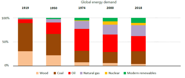

The last century has witnessed multiple transitions to and from different fuels and technologies. Source: IEA[/caption]

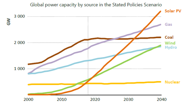

The sustainable development scenario, however, requires wind and solar PV to provide almost all the increase in electricity generation between now and 2040, i.e., little room for natural gas. As for coal, the study accepts usage will remain high in China, India and other parts of Asia. Thus, carbon capture, utilization and storage (CCUS) and biomass co-firing equipment are part of the scenario for those regions along with plenty of coal plant retirements.
The IEA also predicts that under the stated policies scenario at least 120 GW of battery storage will exist by 2040. The hope is that the decline in battery costs will be more rapid than expected or that technological improvements will facilitate an even greater amount of battery storage.

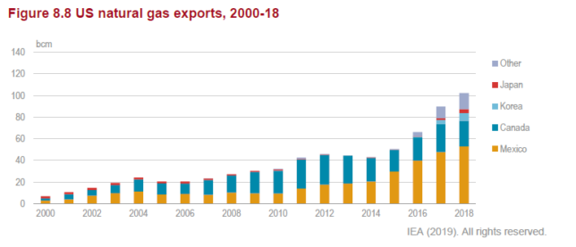

U.S. gas exports reached 102 bcm in 2018. That is a 4X expansion in 10 years. Mexico took 52%, followed by Canada (23%), and then Asia Pacific. The volume of LNG has quadrupled since the opening of the Sabine Pass LNG terminal on the Gulf Coast in 2016. But exports to Europe are expected to surge. The IEA predicts that the U.S. will lead LNG market supply growth until 2023.
