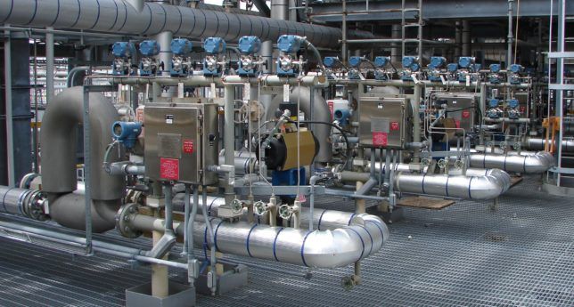

Blending spools for fuel switching

At low levels of hydrogen (up to 20% by volume), no changes to the fuel system or combustors are required, according to Siemens. At higher levels, material selection and sizing of the fuel system needs to be considered, and care must be taken in the combustion system design and operation to avoid flashback. Siemens is incorporating 3D printed components into fuel injector design to ensure safe operation with hydrogen.
“The mixing of natural gas and hydrogen should be undertaken before the fuel mixture reaches the turbine itself,” said Welch. “If this is done, then the fuel system and combustion system can be optimized for the potential range of hydrogen concentrations expected.”

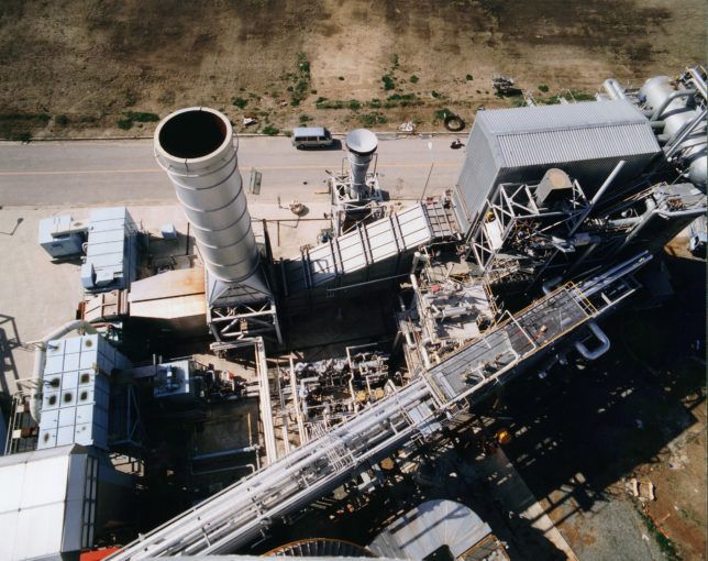

GE’s High hydrogen-fueled 6B gas turbine in South Korea[/caption]
GE
GE’s experience with hydrogen-containing fuels, includes its aeroderivatives, E- and F-class GTs operating in steel mill plants, integrated gasification combined cycle (IGCC) power plants, refineries, and petrochemical plants with waste or process gases containing hydrogen.
As part of the U.S. Department of Energy High Hydrogen Turbine Program, GE has developed a premixed combustor capable of operating on high-hydrogen fuels. This combustor, called the DLN 2.6e, is now shipping on 9HA gas turbines. Based on preliminary lab testing, this combustor is capable of operating on a natural gas blend with about 50% hydrogen (by volume).

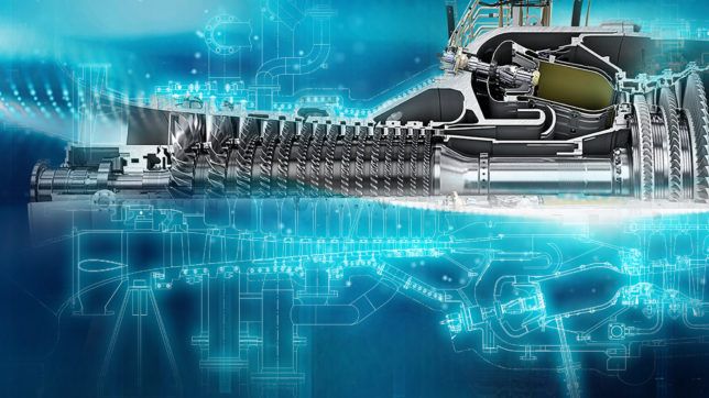

Example of a hydrogen fuel conversion retrofit
