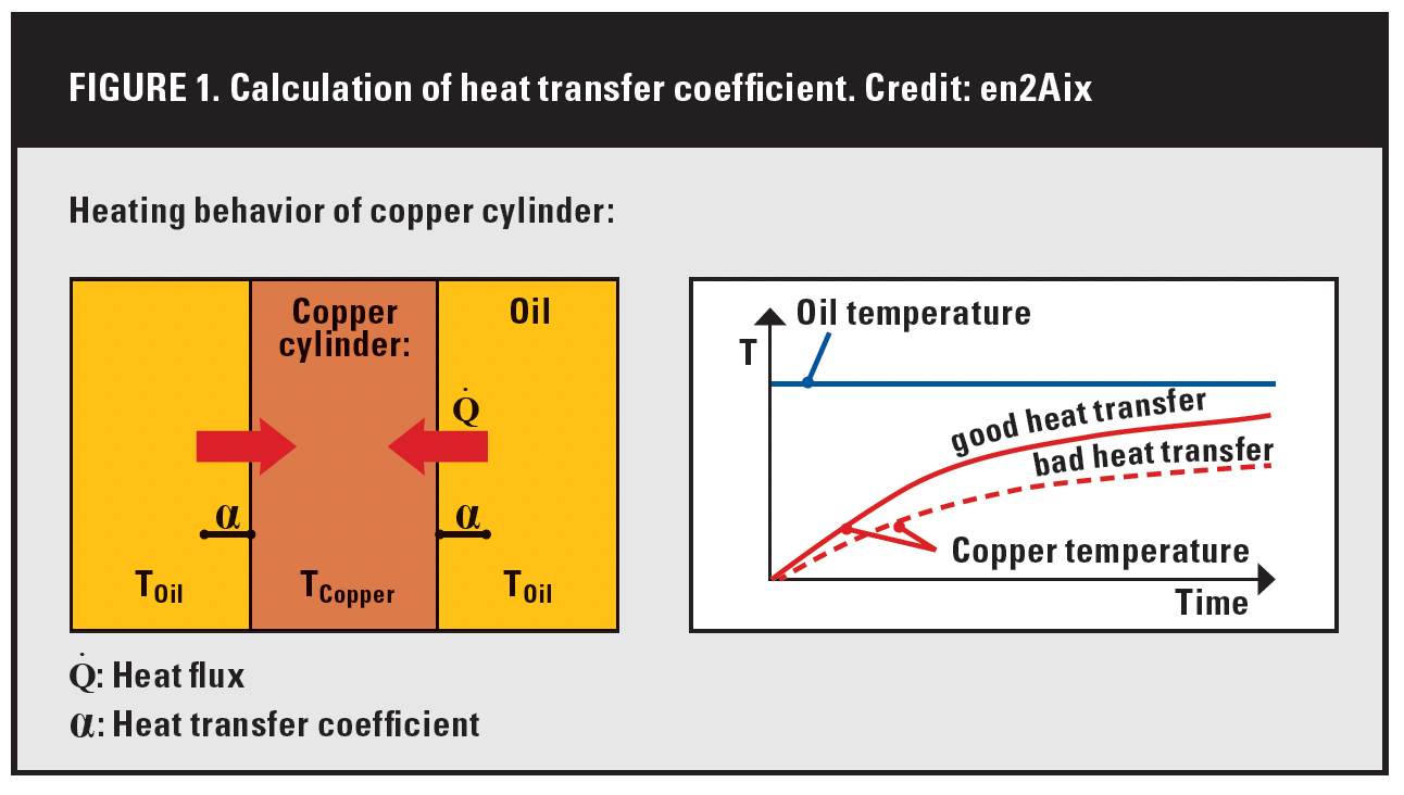

A solid copper cylinder was submerged in a batch of pre-heated and pre-conditioned lube oil containing various amounts of undissolved air. FIGURE 1 shows that heat flux—the rate of heat transfer over a given unit of surface area—is dependent on the heat transfer coefficient of the oil, the surface area of the cylinder in contact with the oil, and the temperature difference between the oil and the cylinder. The relative heat transfer properties of the oil can be deduced by observing how quickly the copper cylinder's temperature rises once it is submerged. The higher the rate of change, the more effective the oil is at transferring heat.

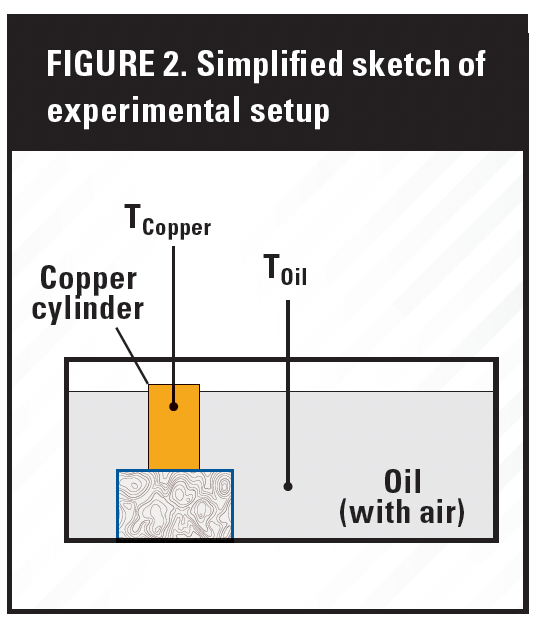

FIGURE 2 shows the experimental setup where the temperature change of the copper cylinder was monitored over time. Several test runs were carried out, taking into consideration different lube oil temperatures, air loadings, and types of lube oil. Three different methods for loading air into the lube oil were also tested.
Injection via nozzle. Air injection into the lube oil via a nozzle (10 bar compressed air supply delivered through radial boreholes) did not replicate a drained oil condition that would typically be seen during actual compressor operation. Several tests showed that the percentage of air by volume in the lube oil only reached ~1%. At these levels, no material effect on the heat transfer coefficient of the oil was observed.
Mechanical aeration/mixing. The mechanical aeration approach resulted in a lube oil condition similar to that of a typical turbomachinery gearbox. The fraction of air by volume in the oil was approximately 6%. This is comparable to the air content of oil drained from STC-GC internally geared compressors.
Oil drained from operating gear. The third test series was performed using oil drained from an STC-GC gear-type compressor.

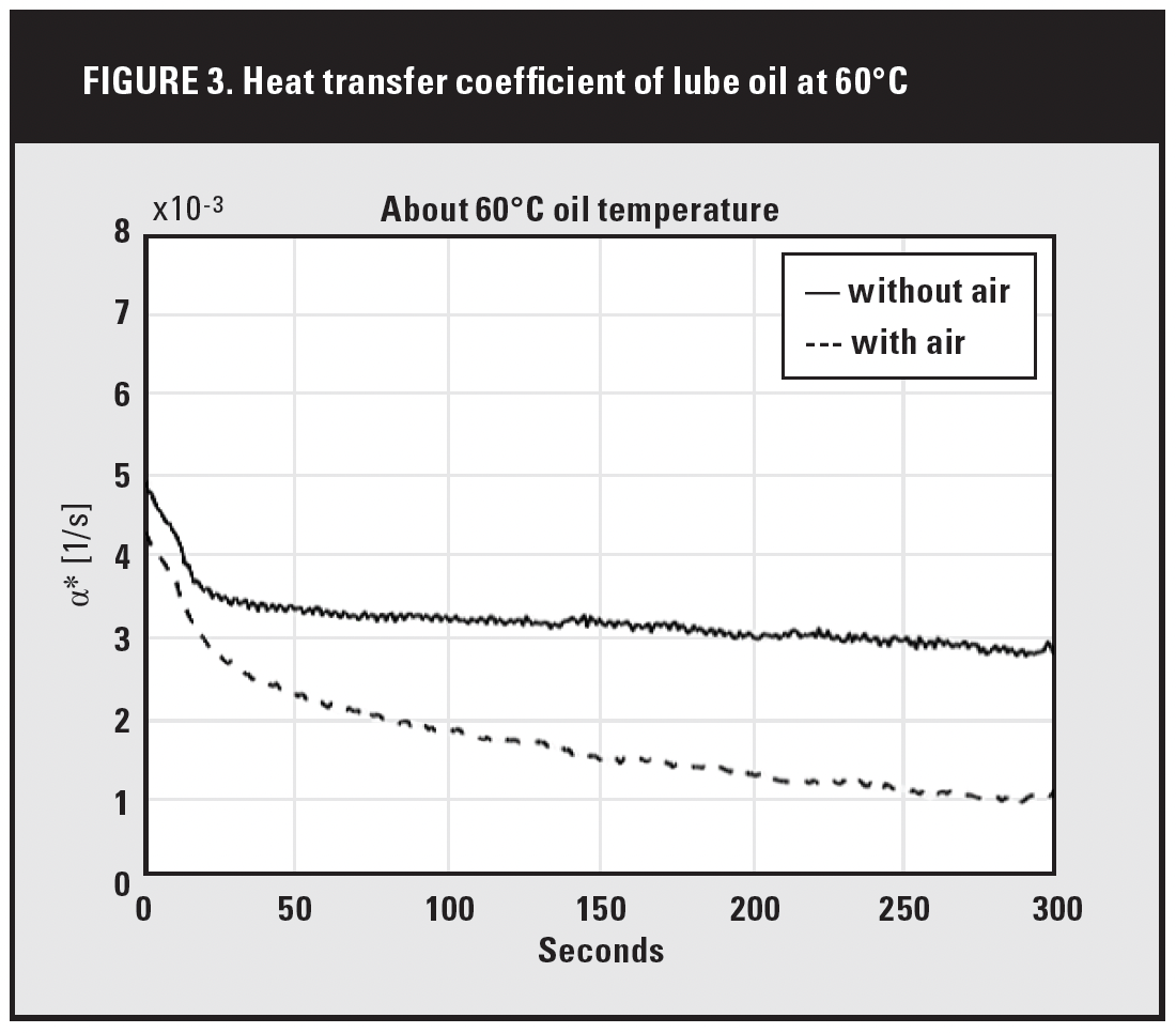

FIGURE 3 shows the heat transfer coefficient over time of 60oC lube oil with and without air bubbles (using the mechanical-aeration approach). The same tests were performed with oil at temperatures of 45oC and 85oC and with an ISO viscosity class of 46 and 68. All tests showed similar results. As shown in FIGURE 3, at certain points during the testing, the heat transfer coefficient was reduced by as much as 50% in oil loaded with air.
An approximate 25% reduction in the heat transfer coefficient was observed on the oil drained from the STC compressor on the stand. However, the collection process took roughly three minutes. This likely resulted in some degassing of the oil before testing, which means that the actual reduction in heat transfer may be considerably higher than 25% during operation.
