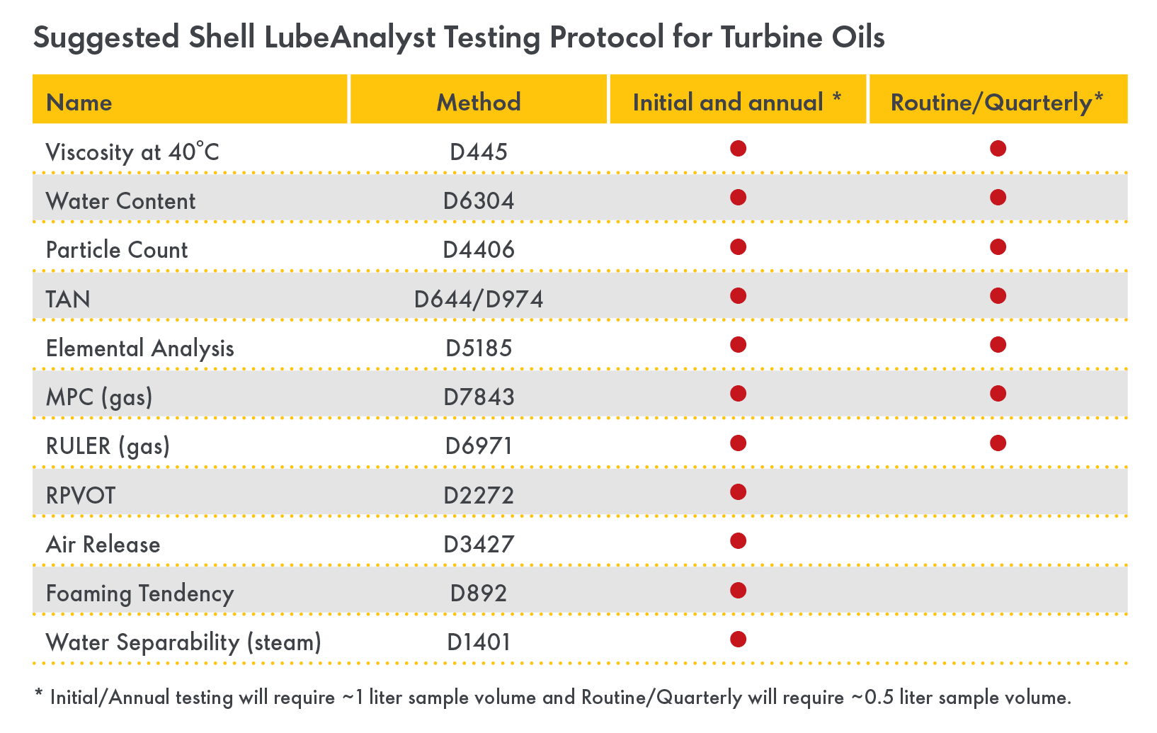

A critical component of managing the oil’s lifecycle to prevent varnish formation is performing the proper oil analysis tests at the correct intervals. The table below details the tests and intervals that should be utilized for varnish formation prevention. The most important sample in the turbine oil process is the first sample taken in the fluid’s life: It should be pulled in the first 8 to 24 hours. This sample will serve as the baseline for all future sample comparisons. A fresh, uncirculated sample as the baseline is not recommended.

All oil degrades with time and use, and thus it will eventually reach the end of its useful life regardless of prevention and intervention. However, measures can be taken to maximize the oil’s useful life, especially concerning varnish potential. Varnish formation is preventable by ensuring the oil does not exceed its solubility for varnish precursors and degradation byproducts. Using the prescribed analysis protocol provides the necessary information to keep ahead of this occurrence. As data predicts cautionary levels of degradation components in the oil, mitigation technologies, such as varnish filtration units and a varnish solvency enhancer, can control the accumulating degradation components.
