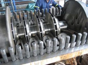

Compressor with non-metallic seals at impeller mouth[/caption]
In a case study it was initially assumed there would be no change required to the rotor or other parts but on assembly it was observed that the labyrinth seals rubbed against the rotor when the horizontal split casing was tightened. It was realized the coating thickness ate up the clearance resulting in jamming of the compressor rotor.
The fouling in the compressor rotor reduced but the foulant continued to foul the flow passages of the stationary diaphragms. We are considering providing a coating to the stationary parts as well so that the performance of the machine could be maintained.
