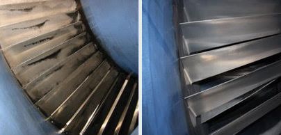

Caption: Inlet guide vanes (left) after 1,200 hours of low-efficiency filtration and the same components (right) after 5,000 hours of high-efficiency filtration

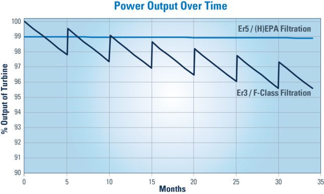

Caption: With a lower-efficiency F-Class filter, multiple compressor
washes may be required over time to recover efficiency and
power output. A HEPA filter maintains steady performance
Efficiency
Efficiency refers to the proportion of inlet air particulates the filter removes, measured by particle concentration upstream and downstream of the filter. This is the most widely recognized filter trait, and until recently, the only one with consistent testing standards. The cleaner air produced by higher filtration efficiency produces better combustion, sustained power output and longer lasting turbine blades. A low-efficiency filter used for 1,500 hours, for example, allows significantly more fouling than a high-efficiency filter used for 8,000 hours.
Of course, there are cost trade-offs to consider. Lower-efficiency filters have a low initial price tag. However, they can sometimes require on- and off-line water washings to periodically regain some of the power output loss due to fouling. High-efficiency particulate air (HEPA) filters cost more initially but stabilize power output due to increased compressor health. Due to being more restrictive, though, the turbine will put out slightly less initial power than a comparable lower-efficiency filter that offers a lower initial pressure drop. It is a case of balancing these factors to determine the right choice, i.e., does the stabilized power output of HEPA filtration offset the decrease in output due to efficiency loss in lower-efficiency elements.

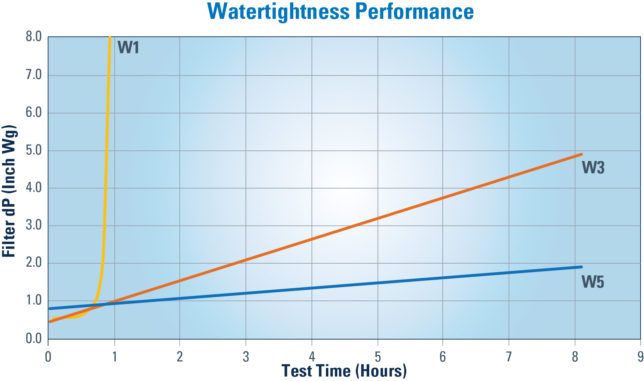

Caption: Higher levels of water-tightness indicate the ability to prevent
water ingress and provide stable pressure drop when challenged
with water. Filter testing indicates how pressure drop increase is
reduced with higher-rated filters.
Water-tightness
How well a filter stops water or how it performs in a wet condition may outrank efficiency as a priority for some operators. In humid or ocean-front locations, salts and other dissolved solids carried by water can be highly corrosive, often even more detrimental than airborne contaminants. GT manufacturers usually recommend that less than 0.01 parts per million (ppm) of salt enter the system. In coastal environments, airborne salt can easily range from 0.05 to 0.5 ppm on a typical day. This is more than 10 times the chloride concentrations of inland areas.
A good way to test water-tightness is to direct a 60-liter-per-hour water spray at the filter over an eight-hour period. The filter pressure drop and volume of water passing through the filter are recorded. The best-performing filters survive the test with at least 99.5% water stoppage and no more than a 2-inch water-gauge (WG) increase in pressure drop across the filter during this test.
