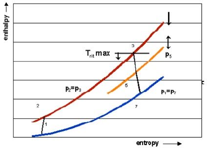

Enthalpy-entropy diagram for the Brayton
cycle[/caption]
The Enthalpy-Entropy Diagram describes the Brayton cycle for a two-shaft gas turbine. Lines 1 to 2 and 3 to 4 must be approximately equal, because the compressor work has to be provided by the gas generator turbine work output. Line 4-5 describes the work output of the power turbine. At higher ambient temperatures, the starting point 1 moves to a higher temperature. Because the head produced by the compressor is proportional to the speed squared, it will not change if the speed remains the same. However, the pressure ratio produced, and thus the discharge pressure, will be lower than before. Looking at the combustion process 2 to 3, with a higher compressor discharge temperature and considering that the firing temperature T3 is limited, we see that less heat input is possible, ie., less fuel will be consumed .
The expansion process has, due to the lower p2 = p3, less pressure ratio available or a larger part of the available expansion work is being used up in the gas generator turbine, leaving less work available for the power turbine.
