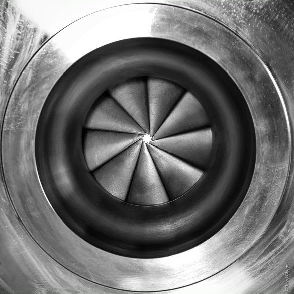

IGV blades at the inlet of a compressor pre-swirl gas flow entering the impeller, reducing the amount of work needed from the main driver.[/caption]
